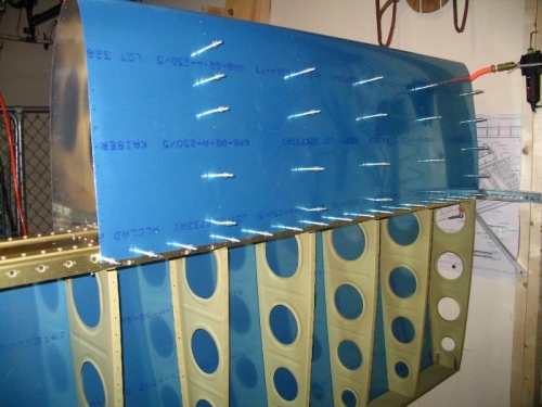

Brief Description:  Lower wing skin & outboard leading edge
Match drilled lower skins to #40. Built wing leading edge cradle from 1/2" plywood and 2"x4"s. Clecoed ribs into place in leading edge skin, then attached leading edge to spar. Still haven't figured out how we rivet the leading edge ribs in place, but that will be a battle for another day!
