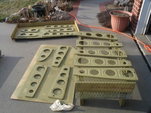

Today I decided to finish the prep work on at least one set of ribs. The weather has been really nice, but I can't take a chance it will change (this is Kansas!), so I elected to clean and prep the left wing ribs today and save the right wing ribs for sometime down the road. First I cleaned all the ribs with a mild detergent and water, then wiped everything down with laquer thinner, and finally applied the Vari-Prime...I love that stuff! It was only in the low 50's, but the primer went on with no problems and dried quickly. So now on to left wing assembly!
Left wing ribs primed and ready for assembly
