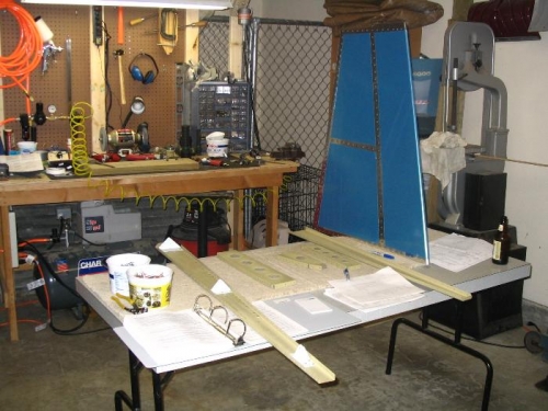

Date:  6-12-2005
Number of Hours:  7.00
Brief Description:  Vertical spar assembly
Dimpled skin, primed substructure, riveted spar doubler and hinge brackets to rear spar, riveted substructure together. Had problems with two rivets on forward spar/lower rib--had to drill out twice, then finally reversed rivet in middle and drove with rivet gun.
