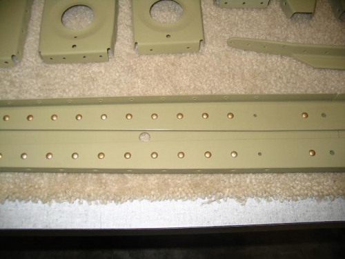

Brief Description:  Empennage priming, riveted rear spar
Primed all HS parts, riveted rear spar reinforcing bars to rear spar. First real airplane part! The priming was a good learning experience -- had some difficulty with parts moving around during spraying. Finally just laid parts down. Riveted using hand squeezer -- need to get shims for pneumatic squeezer!
