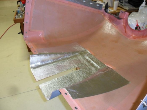

I finished up by installing some heat reflective material on the lower cowling to protect the fiberglass where the exhaust pipes come in closest contact.
Reflective material applied to lower cowling
