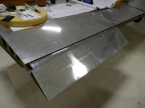

When I had done everything I could on the tail strobe, I turned my attention to the flight controls—specifically the ailerons. I first worked for awhile on checking the push tube rod end bearings. These had been installed many years ago and basically neglected since. All of them needed lubrication, and a couple of them looked a bit rough, but after oiling and cleaning, I deemed them all serviceable. I then started working on installing the left aileron, a process that required a little homebuilding creativity due to the need to place washers (really spacers in this case) on the bolts as I inserted them. I ended up using a piece of scrap .032 to make a “Y” that held the washer in place from below while I inserted the bolt. After getting everything in place, I torque the nuts down and checked for proper and free movement. So far everything looks good.
Left aileron installed
