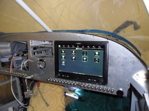

When I finished that I installed the MFD for the first time and powered it up...everything works so far!
MFD power on!
MFD power on!
