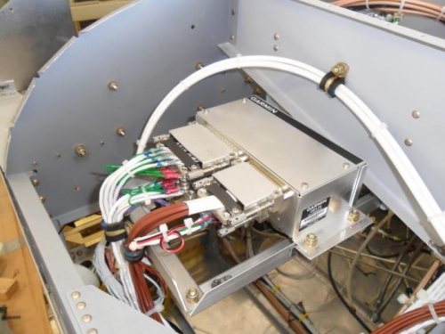

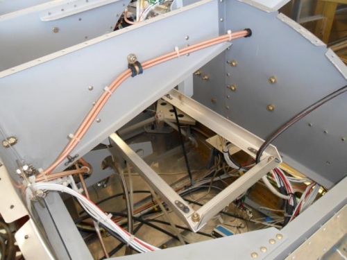

This morning’s session was devoted to finishing up the forward fuselage wiring to facilitate next weekend’s top skin riveting.
Lots of odds and ends to finish:
• Added screws attaching the fuse blocks to the sub panel
• Attached the GDL 39R with six screws
• Glued some edge protection along the base of the sub panel where there was possibility of contact with the wire bundle
• Spliced a ground wire (Steinair left one ground wire much shorter than the others) and ran it through the bundle to the grounding block
• Added a few zip ties here and there to tidy up the bundles

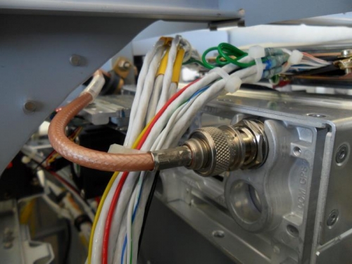

• Put a standoff between the GTN 625 bundle and the RG-400 bundle for support
With that, I decided it was now or never…time to close this thing up!
TNC connector for primary GPS
Left side finished
Left side finished
Right side finished
Right side finished
