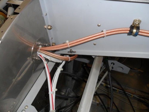

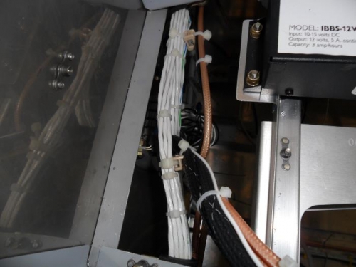

This morning I started by attaching Fast On terminals to each ground wire, and then attaching each terminal to a tab on the firewall mounted grounding block—the proverbial “forest of tabs”. I was a bit surprised that I had almost 20 separate components grounding to this tab, but with about half of those being avionics, it probably is about right. Next I started the process of straightening the bundles and attaching the final zip ties—in this case, white. I had harbored some thoughts of using nylon lacing tape for this, but realized that it would have probably tripled my time to finish this up, so I resorted to the tried and true zip ties. I figure if it’s good enough for the certified aircraft my company produces, it’s probably good enough for me.
I also utilized the nylon stand offs that I had purchased through Mouser to attach the RG-400 (to get at least a little separation for the signal cables from the power cables), and to keep the bundles apart at a couple of key crossing points. When I finished the session, I realized that I was getting pretty close to power on testing of the circuits, so I will have to shift gears to seal the firewall first thing next session to allow me to start closing things up. Progress!
Left side firewall pass through

Bundles converging from tunnel

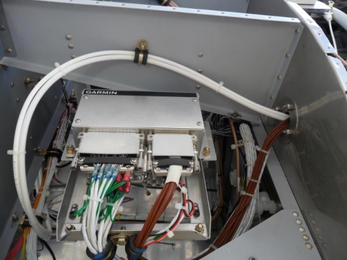

GEA 24 and main power wiring
