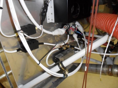

Brief Description:  Standby alternator wiring
Today was an abbreviated session focused on getting the standby alternator wired and ready for installation. Due to the extremely tight space behind the engine when everything is in place, I will wait to actually install the alternator until I’ve finished up the rest of the work in that area.
Wiring was fairly straightforward, 10 AWG from the alternator to the current limiter, and then around the bundle to the main power bus. I’ll install the alternator controller tomorrow and start wiring all of the circuits to complete the installation.
Top box is the standby alternator wiring
