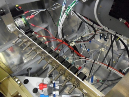

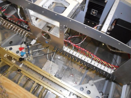

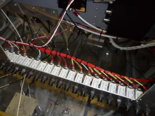

Another wiring session today. After getting the basic wiring done from the circuit breakers to the switches, I put the panel back in the fuselage and started routing the wires from the G3X components to each associated circuit breaker. For some reason Steinair sent the power leads with Faston connectors, but since I’m using circuit breakers I needed #6 ring terminals. After cutting off the Faston terminals and crimping on the appropriate ring terminals, I spent the next few hours organizing wire bundles. As always, the pictures do a good job of showing the work done.
Second go on the circuit breaker wiring
Switches are starting to come together
Overhead shot of the panel
