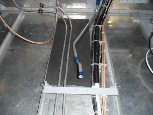

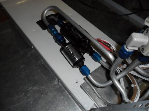

Now to the fuel system. Yesterday before I left I had cut several pieces of foam to fit on the side of the tunnel under the fuel and brake lines, so I finished installing the tunnel cover and then began the process of wiring the fuel pump. Wiring at this point is pretty straight forward—measure, cut, strip, crimp, test circuits and heat shrink to protect. After finishing all of that I used my handy 12V bulb tester to see if it was wired properly. Master switch on, boost pump circuit breaker in, switch on…and it lighted up. I had previously painted the fuel selector cover but wanted to give it more time to cure properly, so I installed all of the fuel lines and the selector without the cover—I’ll finish that off next weekend. Fuel system is almost done. While I was at it I tested the forward carpet and it looks great!

Foam installed under fuel & brake lines
Fuel pump installation

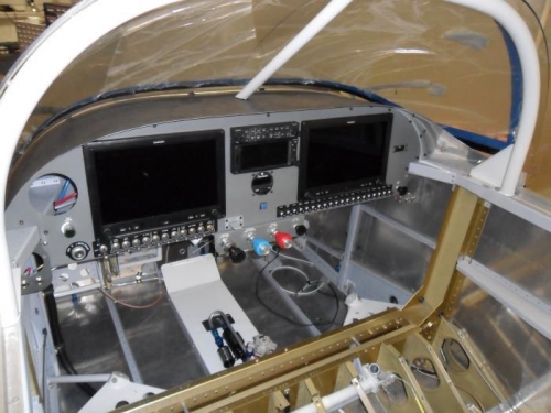

Full view of cockpit with everything installed
