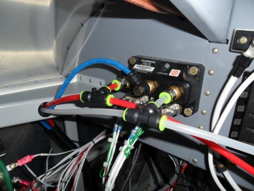

I took the day off of work to extend the Thanksgiving weekend and headed out to the hangar for a short session to finish up the pitot, static & AOA plumbing. Since I decided to add an alternate static switch to the AOA system, I was one “tee” short, so I stopped by the aviation supply department at Lowe’s and bought a fitting. Even if the replacement fitting isn’t perfect, it allowed me to install everything and I can always get a new one from Steinair, I just didn’t want to pay $8 to ship a $3 part. We’ll see when I do a static leak test. I also didn’t want to pay five bucks for a tubing cutter, so I made my own for free out of a piece of phenolic block…worked like a champ.

GSU 25 plumbed with pitot (red), static (white) and AOA (blue)
