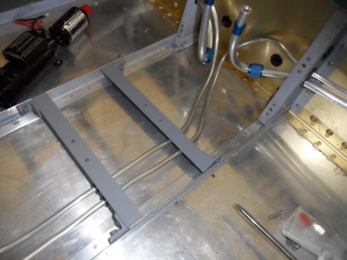

Moving on, I pulled the fuel pump brackets out and drilled holes to allow the brake lines to run through. This took a little while because of the thickness of the metal and the fact that the snap bushings didn't fit quite right. A bit of trimming with a razor blade and then cleaning and priming finished the brackets. Finally I made the initial run with the tubing—I will spend some time tomorrow bending it to ensure there is no interference and then flare the ends.
Initial brake line run
