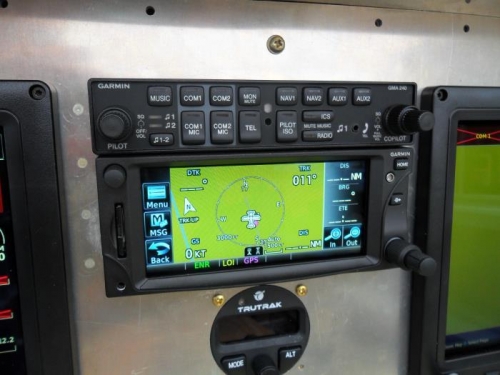

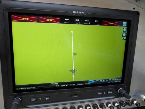

Today I set about completing two tasks—getting the G3X & GTN 625 to receive a GPS signal, and sorting out the issues with the stuck mic on the radio. The GTN GPS signal failure was what I had suspected…when installing the TNC connector on the backshell, I had failed to get the pin inserted far enough. No connection to the unit. That was a fairly simple (and $22 for a new TNC connector) matter of climbing back under the panel and doing delicate cutting, stripping, attaching and crimping work in the cramped confines of that space. Once that was done I attached two BNC connectors to the #1 GDU and GPS antenna and pulled the airplane out on the ramp. The G3X found a signal almost immediately, but the GTN simply showed “No GPS Signal”. I wondered if the open hangar door and the location of the antenna were causing a signal blockage, so I pulled the airplane clear of the hangar door, almost to the taxiway edge and there it was. Now to make the GTN talk to the G3X…but that is just a matter of some simple programming.

G3X Touch knows we're at Stearman Field
And so does the GTN 625...
