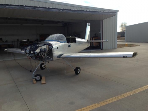

My last task was to see if I could get a GPS signal to the GTN 625, so I aired up the tires, pulled the airplane out on the ramp and waited…and…no signal. After pulling it back in and closing the door, I had a funny feeling that it had to do with installer error on the TNC connectors. A quick check proved me right…that problem can be solved with a little time and money.
Out for a little fresh air...
