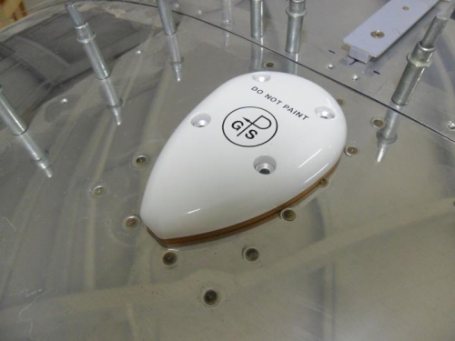

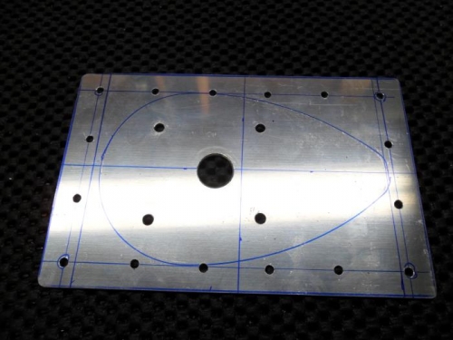

The ADS-B antenna doubler was a bit of a challenge due to the fact that my pop rivet dimpler wasn’t going to do much good in the thick skin under the forward floor. I decided that I would countersink that area and go with AN4 rivets for added strength. After countersinking, I used the same back riveting technique that I had employed previously and got the doubler installed pretty quickly. Next I got another piece of the old panel and fabricated a doubler for the main GPS antenna. This antenna will be mounted externally on the upper part of the aft fuselage. After putting the canopy back on to ensure clearance, I decided that the center section, just aft of the canopy track was the best place. Match drilling, dimpling and priming were pretty standard and after getting all that done I went ahead and riveted the doubler in place.

GPS antenna doubler ready for match drilling
Doubler drilled to fuselage
Test fit after priming and riveting
