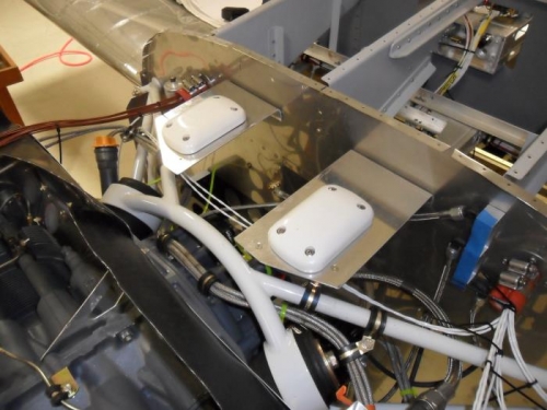

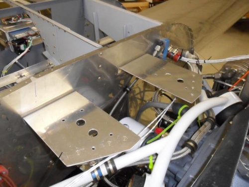

Today I finished up the installation of the left side GPS antenna tray. The right side tray is installed slightly more outboard than the left side, due primarily to the location of a sensor manifold on the left upper firewall. Although it was unintentional (at first), by moving the right side tray to a more outboard position, it left enough of a space between the trays to remove the oil filter without first removing one, or both, of the GPS antennas. Just in case there isn’t enough space, I elected to install everything with screws to make it all removable. This, of course, takes a lot longer because it involves installing nut plates, countersinking for the screws, etc. In the end, I think it will be a more effective installation, and gives me the flexibility to change it as necessary.
