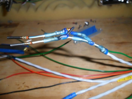

The next step was to cut the CAN bus wires and splice the two from COM 2 into the harness. Unfortunately, in a somewhat hasty move, I actually spliced the wires back together with solder splices before I added the additional wires…oops. Fortunately there was enough wire to add the additional splices, and while not particularly pretty, the continuity check was good and a length of heat shrink tubing gave some additional strain relief.

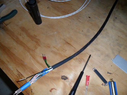

I then started working the wires from the GTN 625 into the harness, which required that I start cutting the tie wraps that held the bundles together. Eventually I had a pretty big mess, so I took some time and cleaned everything up—to include adding some nylon sheathing to the COM 2 bundle. Six hours and that’s all I had to show for it?
