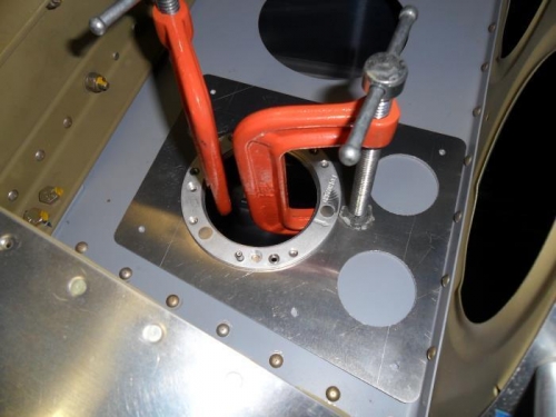

After working on the harness, I moved to the aft deck where I fitted and drilled the GMU 22 attach plate to the structure. With the vertical stabilizer directly above, it’s going to be a bit tough to get rivets in, so I may need to get some brass screws since I can’t use magnetic fasteners in that location. Finally, I spent about an hour of the session trying to figure out where I was going to place the GTX 23. The transponder is actually fairly heavy (about 4 lbs) and requires a very solid attach location. There just isn’t space behind the panel for that, so I think I’m going to move it to a place under the baggage floor—this means I will have to break the Steinair wire harness and forge my own path...that could be fraught with peril!
Riveting GMU 22 attach bracket
Match drilling to aft deck
