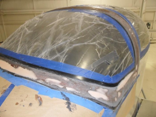

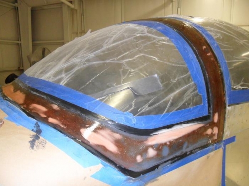

After letting the micro and epoxy cure overnight, I headed out to the hangar to sand it down and determine what needed to be done next. Sanding was pretty straightforward but I did find a number of small voids and low areas that will probably need to be filled with something like Bondo to ensure that I get it all done. Once I finished the sanding, I mixed up a batch of epoxy and brushed it on the entire fairing to saturate the voids in the cloth and fill some of the smaller holes. Once that cures overnight I’ll repeat the process and see what I have left to do. Slow but steady…
Sanding down the filler
Fairing with a coat of epoxy
