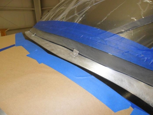

In an effort to keep this project on track for a first flight this summer, I’ve resorted to mid-week trips to the hangar to get some work done. This evening was focused on preparing the windscreen and canopy for the fairing fabrication. I started the process by removing the electrical tape on the lower edge and adjusting it so that it fully covered the canopy skirts on both sides. Once this was done I began the process of sanding the fuselage-to-windscreen transition for an application of epoxy and flox. In order to ensure complete bonding I was pretty obsessive with my sanding, and while I was working on the transition area I also did the initial sanding on the rest of the fuselage and windscreen. After cleaning thoroughly with denatured alcohol I mixed up the first batch of epoxy. Of course there is always something that goes wrong, and in this case it was a malfunctioning pump on the epoxy hardener. Due to the malfunction, the ratio of hardener to resin on the first batch was totally wrong so I discarded that and mixed another batch. (Note to self—too much hardener leads to extremely fast curing…which may generate excessive heat and even smoke).

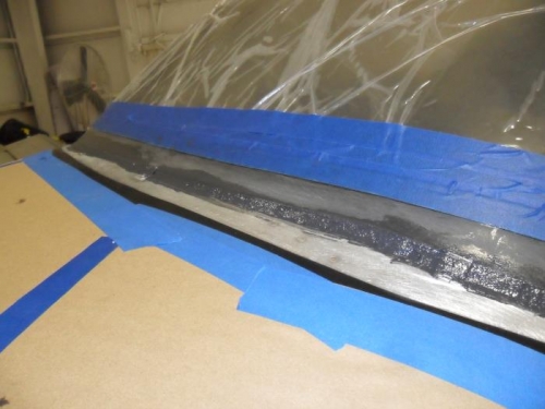

After tinting the epoxy to a gray color, I added flox to make the final product the consistency of toothpaste and applied it to the structure using a zip lock bag as a makeshift caulking gun. I’m sure there are a lot of people out there who could do the job much better (read “neater”) but I think it will serve to fill the void between the fuselage and windscreen and bond the two together. After letting this cure overnight I will plan to start sanding again and will apply the glass and epoxy during my next session.
Fairing area taped off with initial sanding complete
Final sanding done, ready for epoxy
First filler bead applied
