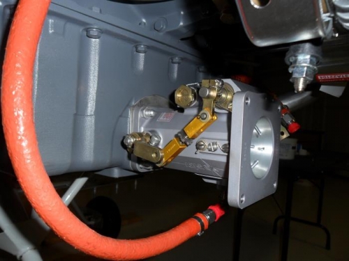

Following all of that, I attached the manifold pressure fitting to the primer port on the #3 cylinder, and then put the throttle body on to test the fit and get an idea of how everything goes together in that area. There are brackets that hold the throttle and mixture cables in place, so I’ll probably work on those next.

Test fitting the throttle body
