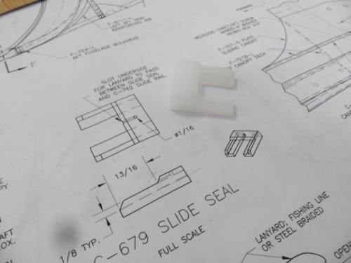

The assembly that joins the two aft skirts together is aptly named the "doghouse" due to its appearance that makes it look like that place we all live occasionally. There is a small nylon seal that fits inside the opening to ostensibly close it off from the majority of air and water that might enter. This block must be fabricated per the plans, so I used a razor blade to shape it to the correct specifications. Lots of up and down the ladder to check fit and trim. Nothing too interesting there.

Aft slider seal...
Aft slider seal...
