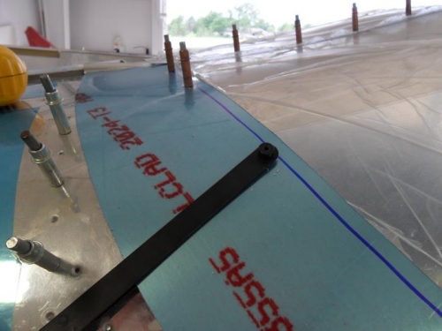

Using the hole finder to drill right side

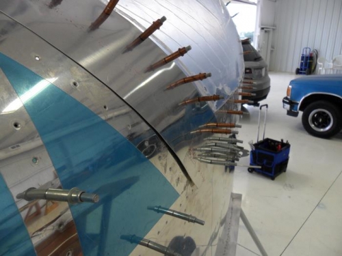

Still needs some shaping to get a better fit

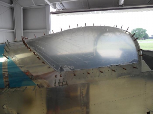

Right side skirts are almost done
