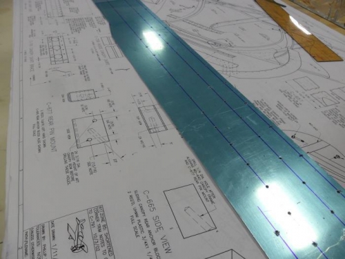

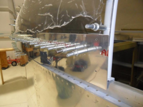

Back to the building. The actual side skirt is a 4" x 32" piece of aluminum that runs from the bottom 5/8" on the side of the canopy to about 1/2" down on the sides of the fuselage. Ideally this fits perfectly against the sides when the canopy is closed. I've read a lot of stories to indicate this is not likely to happen, so I've got a few backup plans in mind. After all of the requisite marking, drilling, etc, I drew a centerline on the canopy frame and began drilling the skirt to the frame. Once that was done the work shifted to the inside bracket which must be match drilled through the outside skirt, blind through the inside skirt, and hopefully directly into the hole in the canopy frame. This wasn’t going as well as I’d hoped, so I stopped after only a couple of holes to assess.
C-660 side skirt cut and drilled

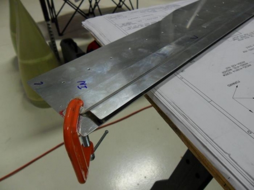

Skirt is drilled to the canopy frame
Lining up the skirt and inside bracket
