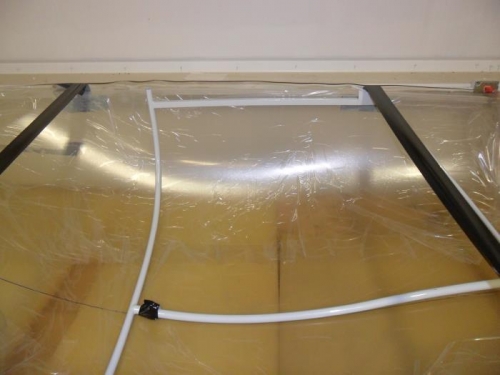

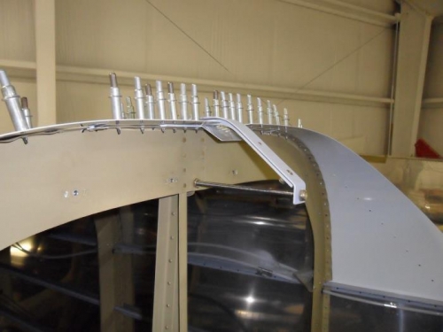

Tonight I started by measuring and remeasuring the canopy frame to make sure I had it on correctly. It always throws me a bit when the manual says one thing and my measurements say another, but I have to remember that I'm building this particular aircraft, not Van's. The measurement in question suggests that the canopy tracks should be approximately 40 13/16" apart, but mine are about 3/8" wider with the canopy frame inside of the fuselage skin by 1/16". I can't make the fuselage any narrower (nor would I want to), so I accepted it and drilled the brackets.
Following that, I measured and drilled a couple of holes for the guide rail so that I could more firmly attach it than it was with duct tape. Then I drilled the 1/4" holes for the threaded rod that helps support the aft frame. Finally I took the canopy frame over to the canopy and began my measurements. Enough for the night.
Aft frame brace initial fit
Checking the frame against the canopy
