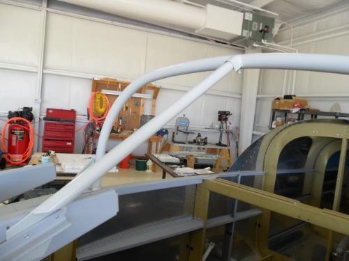

So now that I was all warmed up, I decided to fit and attach the forward brace that attaches the roll bar to the forward fuselage. A lot of plans study, some fitting and drilling, and that was done. During this process I had to reattach the forward top fuselage skin, so it is starting to look more and more complete. In fact, after the canopy is finished, I will pretty much be done with the major assembly tasks, and aside from riveting the top skins on, the sheet metal work will be almost done.

Roll bar is in and front brace fitted
