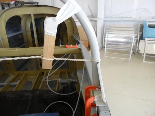

The builders manual says something like "if the steel tube needs to be bent inward, simply place one end on the floor and push against it. Go sloooow, it's easy to bend too much". No it's not. In fact, I spent 30 minutes bouncing against the tube and didn't get even 1/16th of an inch of progress. The second photo shows how I finally got the tube to bend into place.

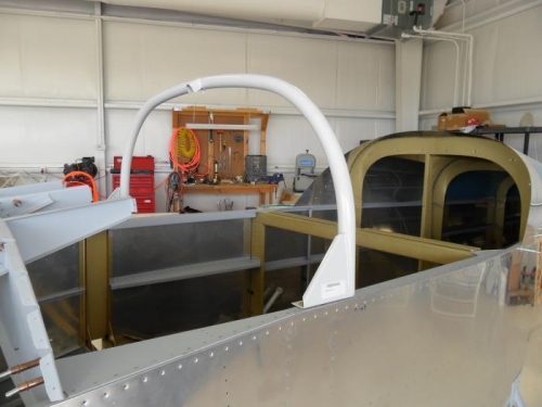

With the tube finally in place I climbed inside and used my #40 flexible bit to drill the first hole. After I got one hole through the steel of the frame, the bit broke on the second hole. Climb out, grab the #30 bit, climb back in and make it work. Finally got the holes drilled and had to enlarge all of them to the appropriate size. Now to put the bolts in...and nuts on. Back to the same problem I faced before. I left to figure this one out another day.

This is one way to pull the roll bar together
Finally...
Finally...
