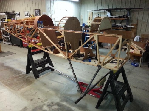

Trial Fit Main Gear
Using a piece of tubing to keep the axles aligned and a floor jack with a 4x4 block as a cradle, we raised and positioned the main gear to the fuselage. Looking good so far.
Fitting LG to Fuse
