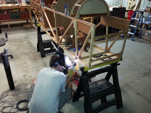

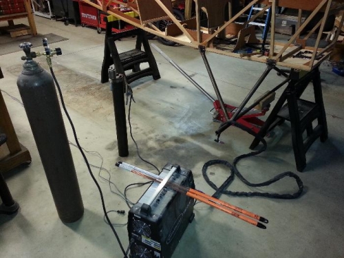

Josiah came by to help me fit the main landing gear. Once the main lugs were positioned on the fuse fittings, we squared it to the tail post. Each axle measured 160-7/8" to the center of the tailpost. One we measured, checked, measured again, checked and measured again... we tacked the main gear lugs to the fuselage fittings. We chose to do this on the fuselage in order to ensure the correct alignment.
Josiah's TIG Welder
Josiah's TIG Welder
Josiah Tacking a Lug
