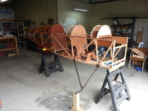

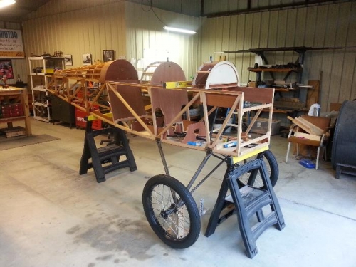

Brief Description:  Landing Gear Struts
Drilled landing gear struts and started sizing up strut spring installation by determining axle angle... looking at 3-4* camber. Everything fits well, and just for fun we slid the wheels on the axles. Had to remove the bushings because they are a bit too snug at 1.500" ID... axles are ~ 1.510 OD so the bushings will need a little work.
