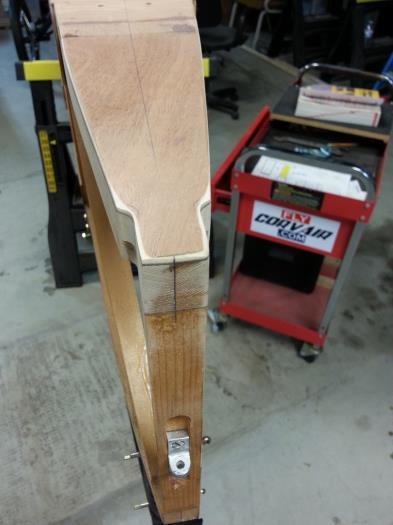

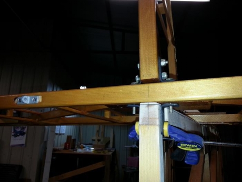

Brief Description:  Tail Surfaces
Continued work on the tail surfaces. Had to figure out how to attach the lower mount fittings as the top fittings are straight while the bottom were angled. The fix was to use the router to square up the top longerons... now they align perfectly and I won't need to make new fittings.
