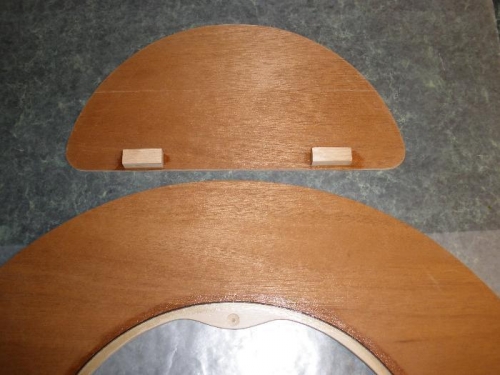

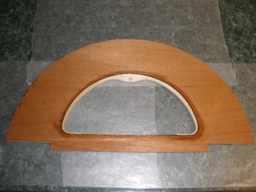

Working on the helmet box so that I can get the turtle deck completed. I cut the door by hand using a hoby knife... wow, that 1/8" mahogany ply is tuff stuff. I got carried away in a spot or two, so the gap around the door opening wasn't as straight as I wanted. To fix this, I sanded both parts to get the proper spacing, which was too wide after all that sanding. The next fix was to install a 1/42" black walnut filler strip, which should give a little accent around the door opening and fill the gap a bit.
Pilot Box Opening
Pilot Box Opening
Inside of Door with Hinge Blocks
