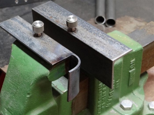

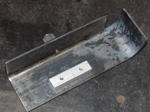

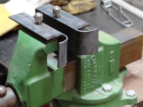

Finished up work on the flattening press. While all the cutting and forming was done last night, I discovered that I needed a way to secure the press to the vise jaws. I have some old SS thumbscrews, so all I needed was a block to act as a brace. These things work great so far… I need to heat up some tube to really put them to the test.
For making a center tab
For making an offset tab
Alumkinum block and thumbscrew hold to vise jaw
