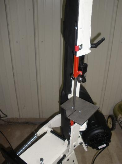

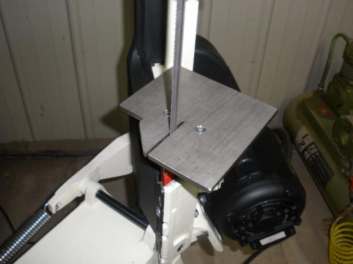

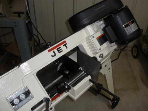

The stock table that came with my band saw is junk. It is ok for ripping larger pieces, but small detailed work is difficult, so I fabricated a much improved table from .250" stainless and shaped it in a manner that doesn't require removal or reinstallation when going from horizontal to vertical and back.
Small but Stout and Adequate
In the Vertical Position
Fully Down in the Horizontal Position
