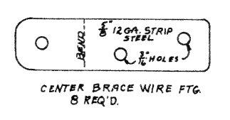

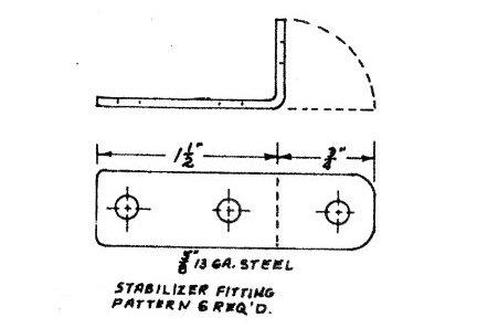

Brief Description:  Empennage Fittings
I fabricated about a dozen small and simple fittings that will be used to attach the tail surfaces and their support cables. None were difficult, but like everything else they take a little time to make them properly. I didn't take any photos of these simple items, but they have been cut, drilled, bent, sand blasted and painted.
