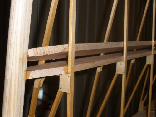

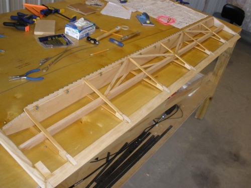

With the aileron spar and aileron braces clued in place, I am finally able to cut my aileron free. I know that everyone says to completely finish the aileron before cutting it free in order to keep it perfectly true, but all I have left to do is add the 1/4" x 1/4" filler strips.
I was hoping to get a bit more done today, but the weather is crappy... again. I got the aileron cut free and the capstrip cleaned up, but I don't have any 1/4" x 1/4" strip on hand... I'll need to cut some from scrap material. With rain falling outside, it's no fun to open the doors and run the table saw. I'll do it next time.
Top Cap
Top Cap

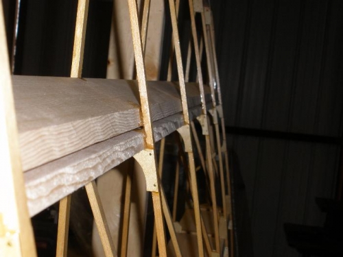

Bottom Cap and Wing Tip Bow
Shown with Braces and Fillers Installed
