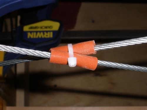

With my hardware and compression struts installed, I started my day by applying tension to the drag/anti-drag cables. I started by adjust all four turnbuckles by hand as tight as I could get them, then I started working around the horn giving each turnbuckle 1/2 turns, checking each cable with a tensiometer as I went.
I did a little test a few weeks ago with a cable. Many of the guys on the forums said that if tuning cables by ear, they should be tightened to the point that they resonate to the tune of G, like a guitar string. I did this and then checked the cable with the tensiometer… it read ~190 pounds. I spoke to Chuck Stephenson (local A&P AI) about this reading, and the note of G style adjustment. He confirmed that strumming the cable is a fairly accurate method, and also thought that 190 pounds of tension wasn’t unreasonable.
Anyhow, I proceeded to adjust the turnbuckles until I got each of them in the 190 pound range. A fellow could chase his ass all day (and then some) trying to get each one of these cables adjusted exactly the same, but I think mine are all within 5 pounds of each other. Once adjusted, I secured the silicone tubing between them in order to reduce wear, but I still need to install safety wire.
