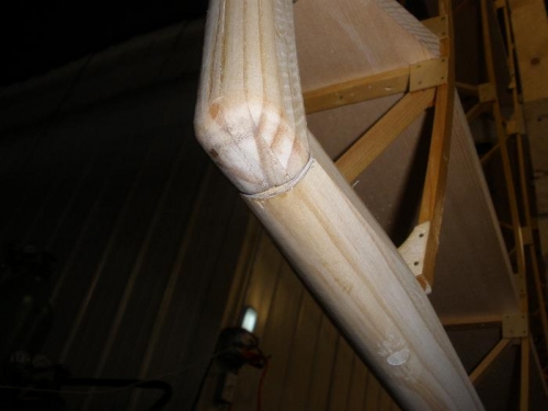

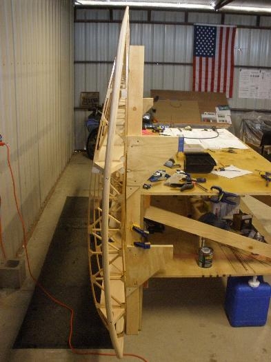

Brief Description:  Installed Left Wing Tip Bow

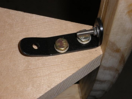

Installed left wing tip bow. I had to drill and countersink to accomodate10-32 SS Fillister head bolts. These are not glued in place yet, only bolted. I will glue and install gussets next spring when the weather warms up. The leading and trailing edges match perfectly.
Left Wing Tip Bow
Left Wing Tip Bow
Wing Tip Fastener and Cable Attach
Leading Edge
Leading Edge
