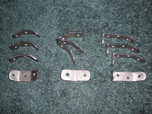

Tonight I fabricated the cable attach and wingtip bow fittings from 11ga. (.100") 4130 sheet steel. These weren't too difficult. The angles and placement of the holes aren't extremely critical, so I was able to batch drill each stack of four fittings. They came out nearly identical... certainly good enough for cable attachments.
