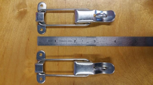

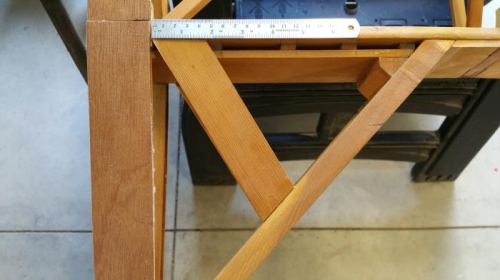

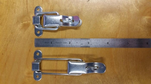

Prior to covering, I needed to determine the mounting position and latch configuration for the center section cover. I have a good set of latches, but the bail was way too short, so I used welding rod to fabricate longer bails, which should work well once I get the hatch fabricated.
