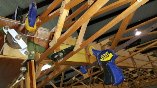

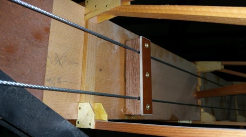

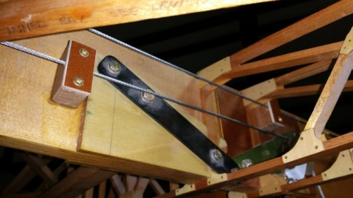

I fabricated cable guides and rub blocks for the wings using left over Brazilian Cherry and some phenolic sheet for backing plates.
