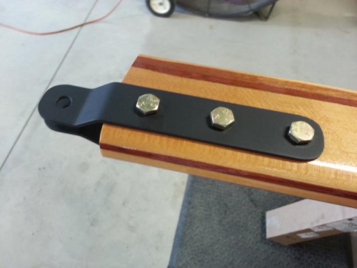

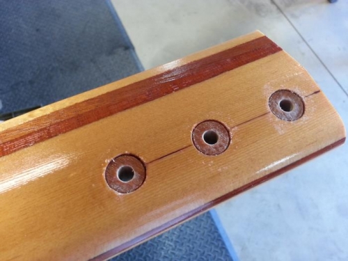

Preparing Lift Struts
In order to provide better tear and crush resistance, I chose to install .750” phenolic inserts where the lift strut attach fittings were to be installed.
.750" Phenolic Inserts
