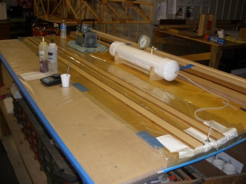

Lift Struts - Laminating Outer Caps
Went to Markles to borrow his vacuum bagging supplies so I could get going on laminating the spruce/cherry outer caps. I got the system set up and then glued up a couple of planks.
Two Planks in the Bag
Drawing Down
Squeezing Out Excess Resin
