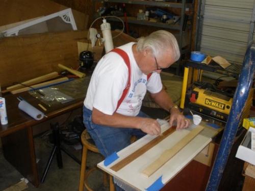

After hearing about this process on a couple of occasions, I finally got to see this vacuum bagging stuff in action as Jim helped me laminate my cabane struts. As mentioned before, I am using Sitka Spruce and Brazilian Cherry. Jim showed me how to apply a nice thin and even coat of epoxy in order to minimize waste and provide full coverage on the surfaces.
Jim Working Over the Epoxy

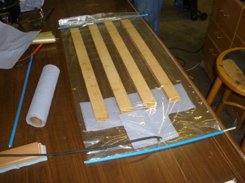

Four Cabane Struts Ready for Vaccum

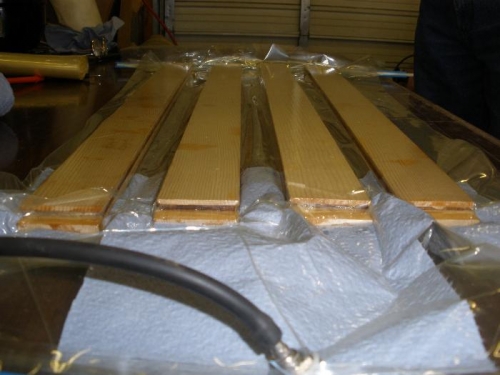

Under 20
Under 20"Hg Vacuum
