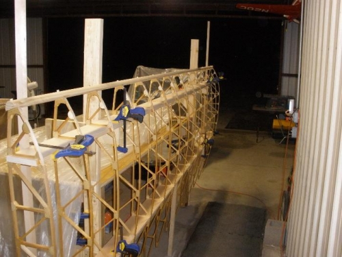

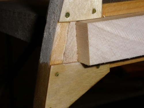

Installed Leading Edge and Spar Wedges
Installed leading edge and capped bolt holes with 3/8" dowel. I will trim and sand the dowel after the epoxy cures. I also glued the spar wedge spacers in place.
Right Wing Leading Edge Installed
Spar Wedge
