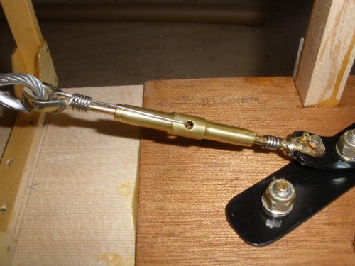

Safety Wired Turnbuckles
I installed .041" safety wire to the drag/anti-drag turnbuckles. I was telling Roger Wieden what a tough chore it was... he said I should have used .030" wire, which would have been sufficient and easier to work with. I think I'll order a roll.
