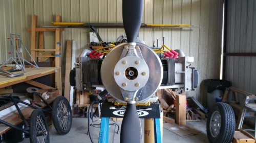

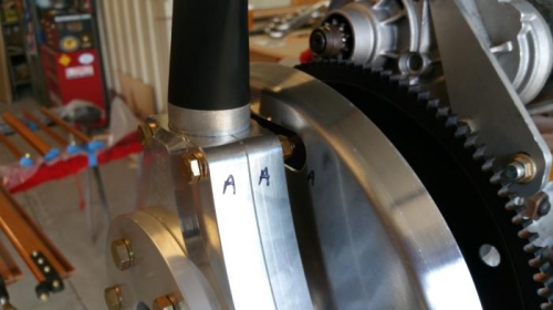

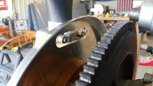

Prop/Spinner Mounting
Mounted prop for the first time with spinner backplate. The backplate had to be machined for bolt clearance, which should allow for ground adjustability without completely removing prop from hub.
