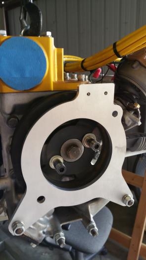

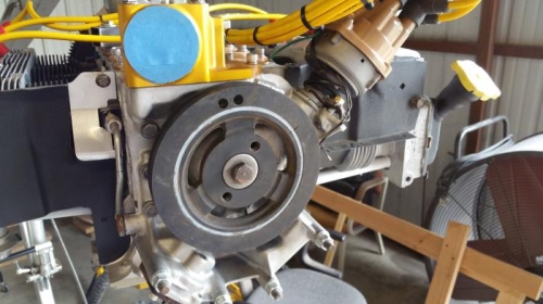

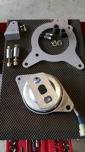

I received my Rear Dynamo mount from SPA (Sport Performance Aviation) and got it installed. This kit moves the dynamo from the front side of the engine where it would be belt driven, to the rear of the engine where it is driven directly from lugs mounted to the harmonic balancer hub.
Harmonic Balancer
Harmonic Balancer
Kit Components
Kit Components
Mounting Plate
Mounting Plate
